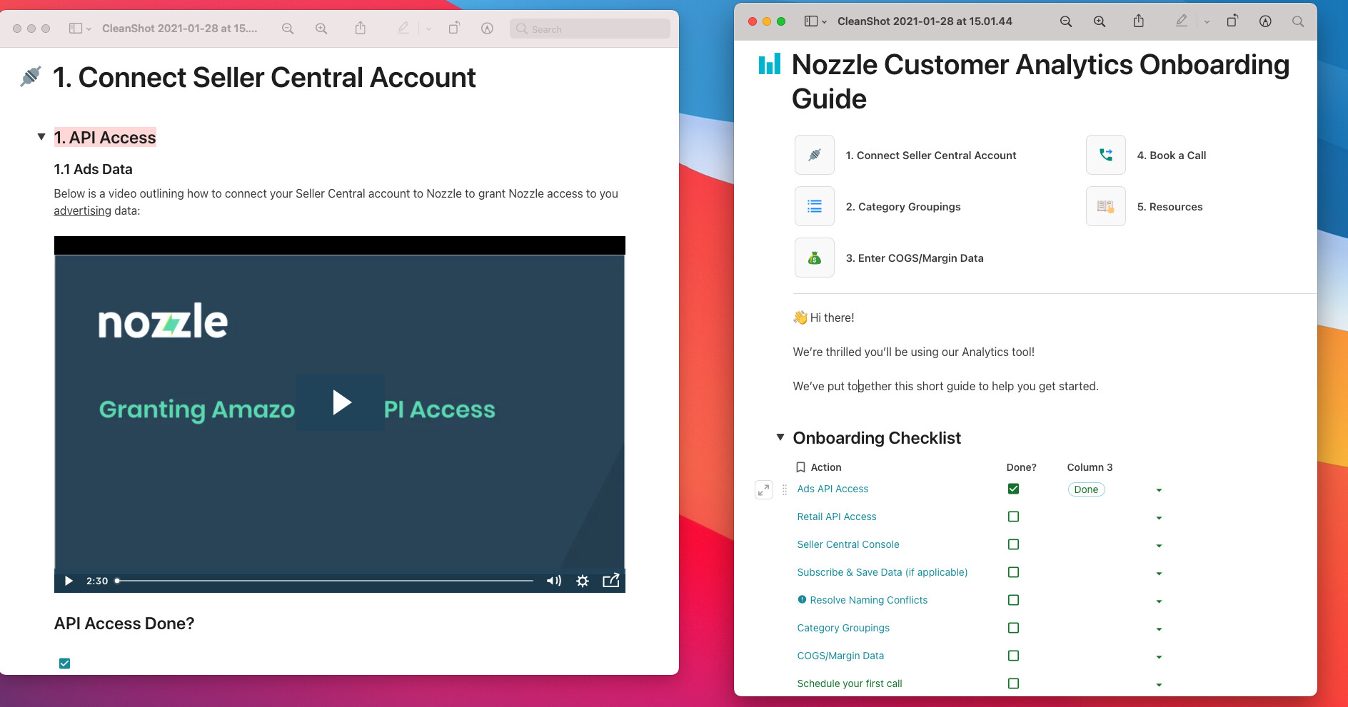

Hi there, I’m pretty new to Coda. So basically I’ve created an onboarding doc for new customers that contains a bunch of sub tasks that are contained in pages/subpages. I would like to have a check box under each sub task for the suer to check once completed.
I would also like a summary of the status of all the tasks to appear on the homepage. What’s the best way to do this as I can’t seem to connect/reference a checkbox?
Thanks so much in advance!

Apparently as a new user I can only put one embedded media in this post so I’ve put them next to each other…
So for instance, step 1 in the onboarding process is to Connect a Seller Central account to our tool. This is a subpage. I have a video explaining how to do it with the idea of a checkbox being there for them to use once they’ve completed the task.
On the homepage, I have an Onboarding checklist that I’d like to reference the status of the checkbox that’s contained in the Connect a Seller Central account subpage so that there’s a central place in the homepage where they can check on the status of all the tasks they need to do (these tasks are all in separate subpages).
Hope this makes sense?
