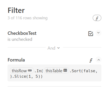

Hi, guys.
Iāve used the formula [thisRow.In(thisTable.Sort(false, thisTable.crITic).Slice(1, 5))] to view the last X rows, but it seems that it doesnāt ācollaborateā with another added filter, despite their order.
This is how it looks just with the split filter:
and this is how it looks when I filter by daily/zilnic column.
Iāve also tested it with a checkbox column and the result is the same as in my case (lookup column).
Do you have any idea? Thanks.
Hello @Alexandru_Dan ,
I donāt mind helping you out and I do have a gut feeling about the cause of your problem, but if you donāt show us the daily/Zilnic column, it is kind of hard to give you any advise.
If you share a dummy doc with your setup, but without any private data, you will get the best help, and usually pretty quick too.
Greetings, Joost
