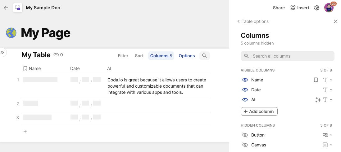

Thanks for the message, and we’d always love feedback on how and where you are using Coda AI. We are actively working on a dashboard that can give admins visibility into which docs are consuming credits, and also happy to work with you if you want to contact us at support@coda.io. In the meantime, here’s a few tips:
  1. Take a look at any hidden columns that might be using Coda AI. If a prompt is referencing another value, and those values update, it’ll refresh the AI.
  2. Hidden rows do not generate new AI content. if you have an AI column and update the prompt, Coda AI will not generate new content for rows that have been filtered. Thus, it can help to filter down any large data sets before you apply AI at the column level. I’m double checking on this one and will update if I find it’s not the case
  3. Test out any prompts in one or two cells before applying the prompt at the column level. You can do this by pressing the AI (sparkle) icon in one cell, or highlight multiple cells then press the icon.
  4. Take a look at the doc map (under your doc settings) and under buttons and controls, anything with a sparkle icon is an AI block. This will help with finding canvas AI items, but table columns don’t show up here. You’ll have to check tables individually, but you’ll see the AI :sparkles: icon next to any columns in a table that are using AI.

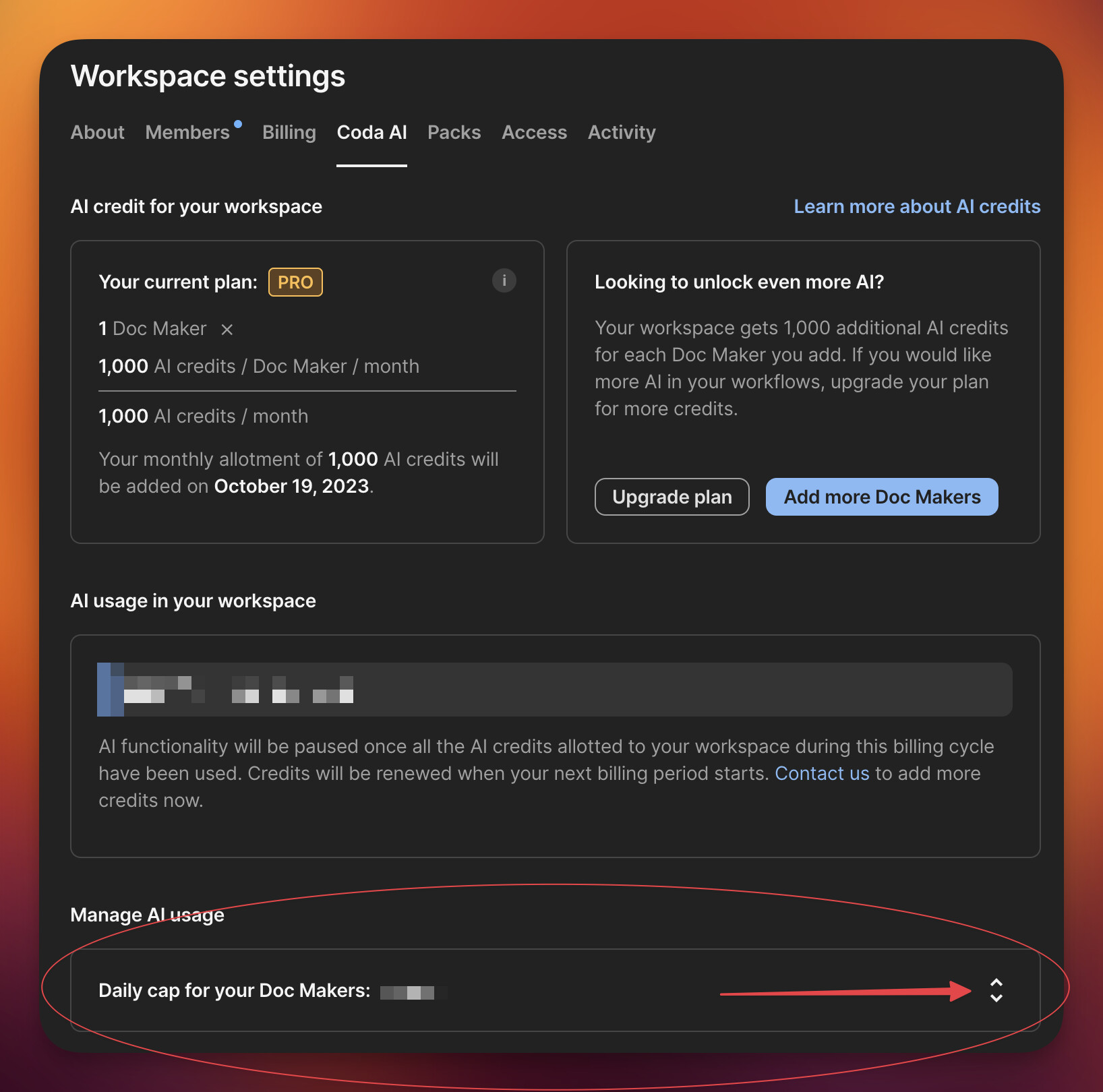

It’s definitely a bug, and you may be able to gain some temporary relief by modifying this setting -
It is a bug and Coda said they’re going to work on a feature to show which docs are adding to the cap. Thanks yall
