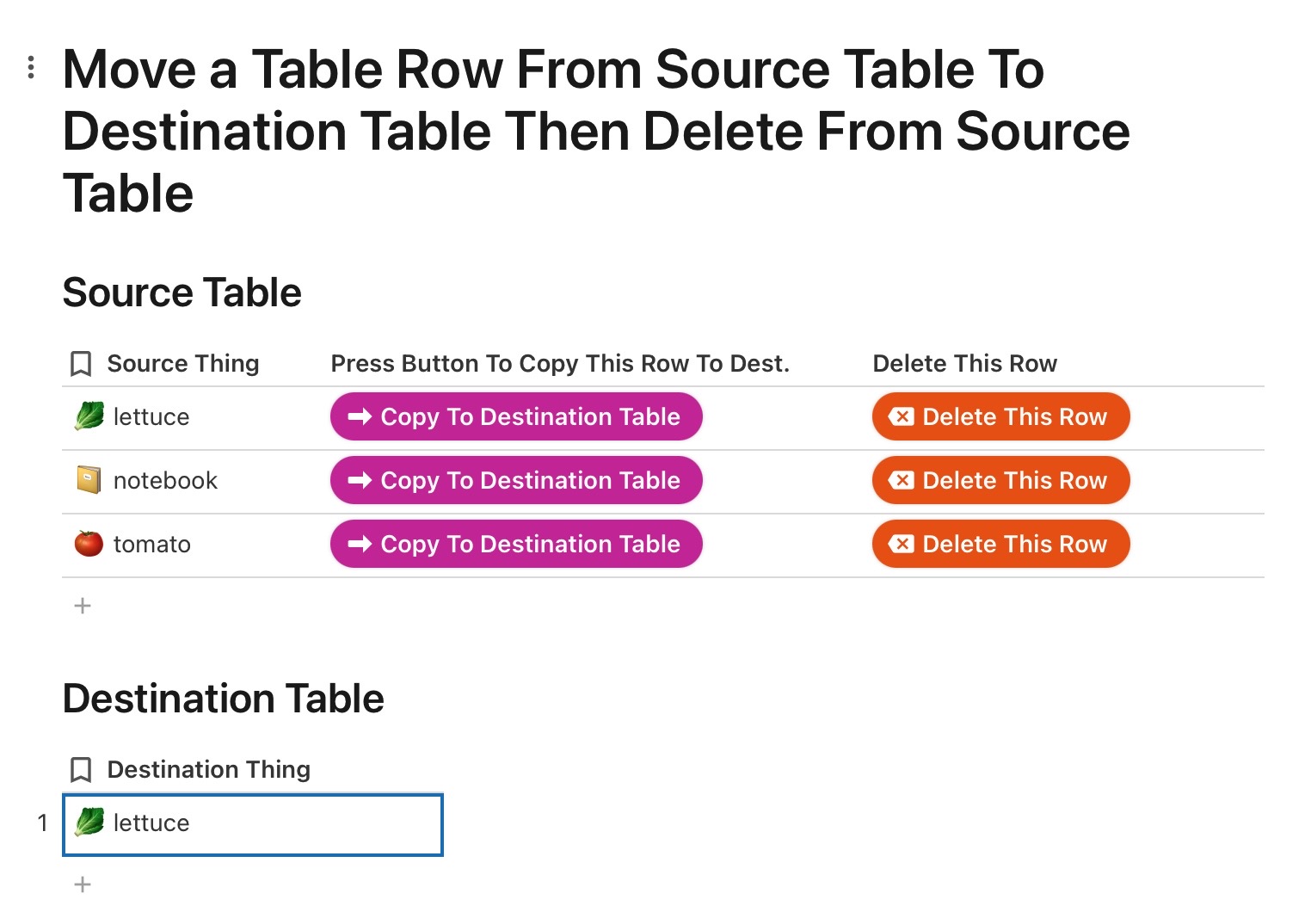

Here is how far I got. I want to go back and combine both actions into one button. Like @Piet_Strydom suggested in his reply.

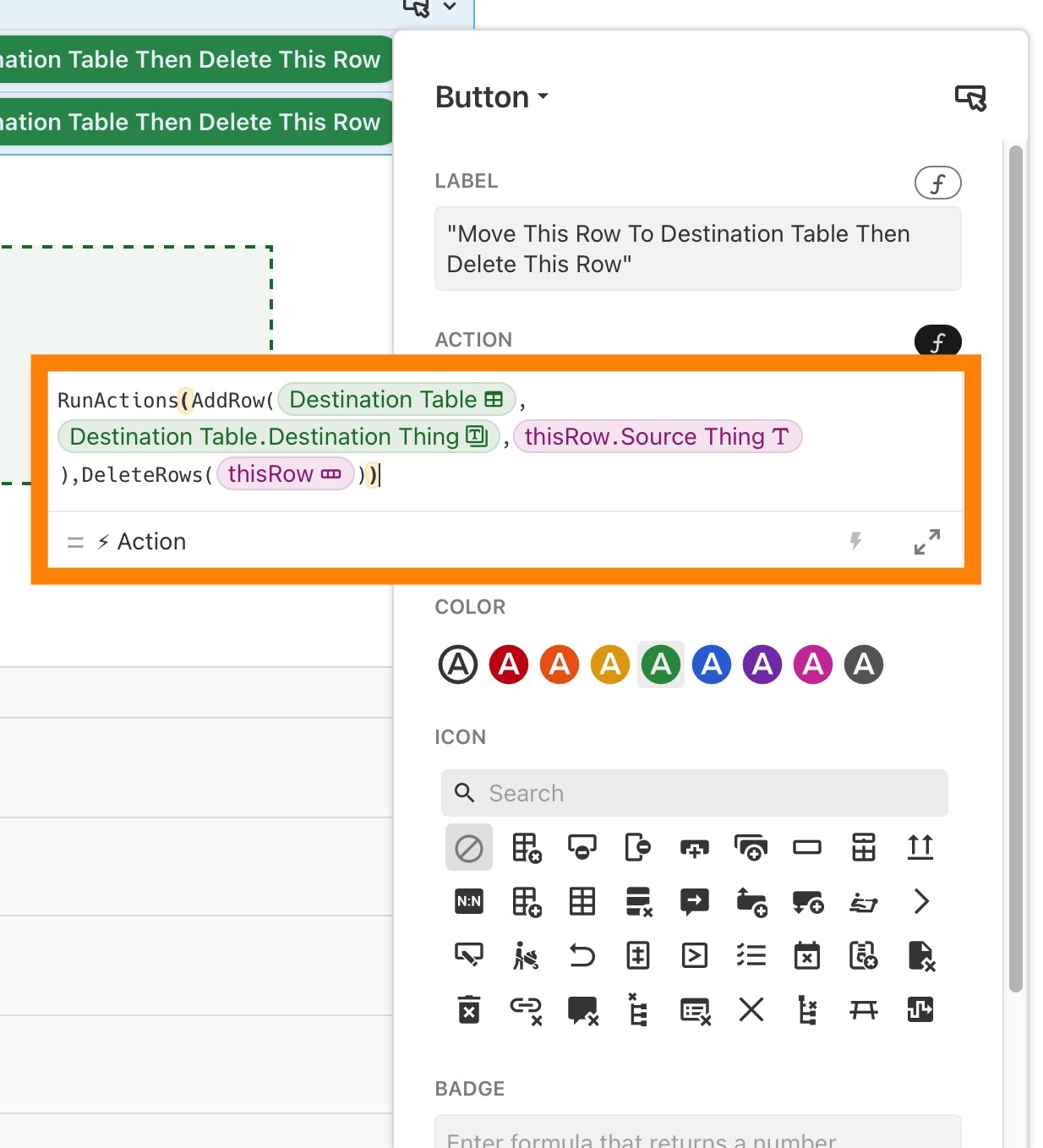

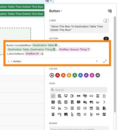

If you want to do that, just wrap your two actions with the RunActions() formula.
So in your button, write a formula that is something like:
runActions(addRow(arguments), deleteRow(thisRow))
Thank you Thank you ! Going to try now
Got it to work using your suggestion. Thank you so much!!!

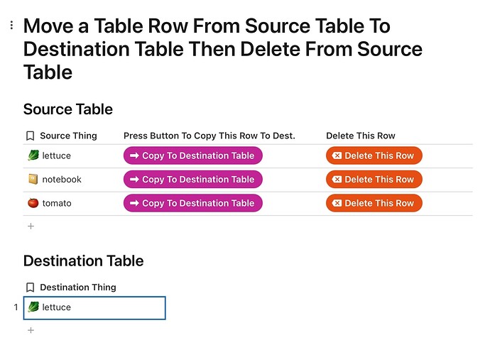

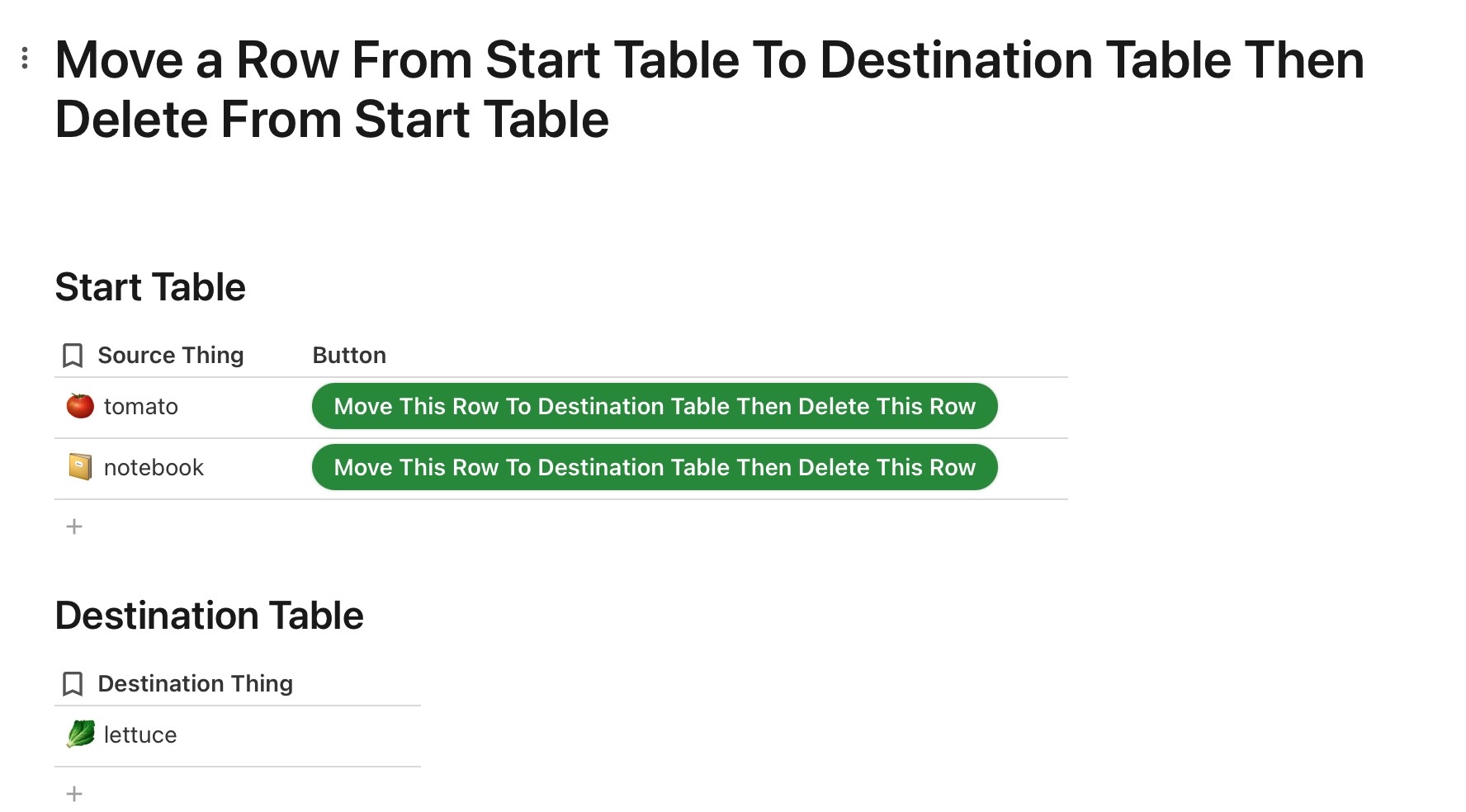

Below are two screenshots. The first screenshot shows the finished thing. The second shows the magic formula that @Scott_Collier-Weir suggested.
