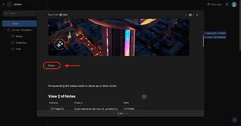

I’m not sure if I just don’t understand the concept of properly using canvas column templates or if this is extremely buggy.

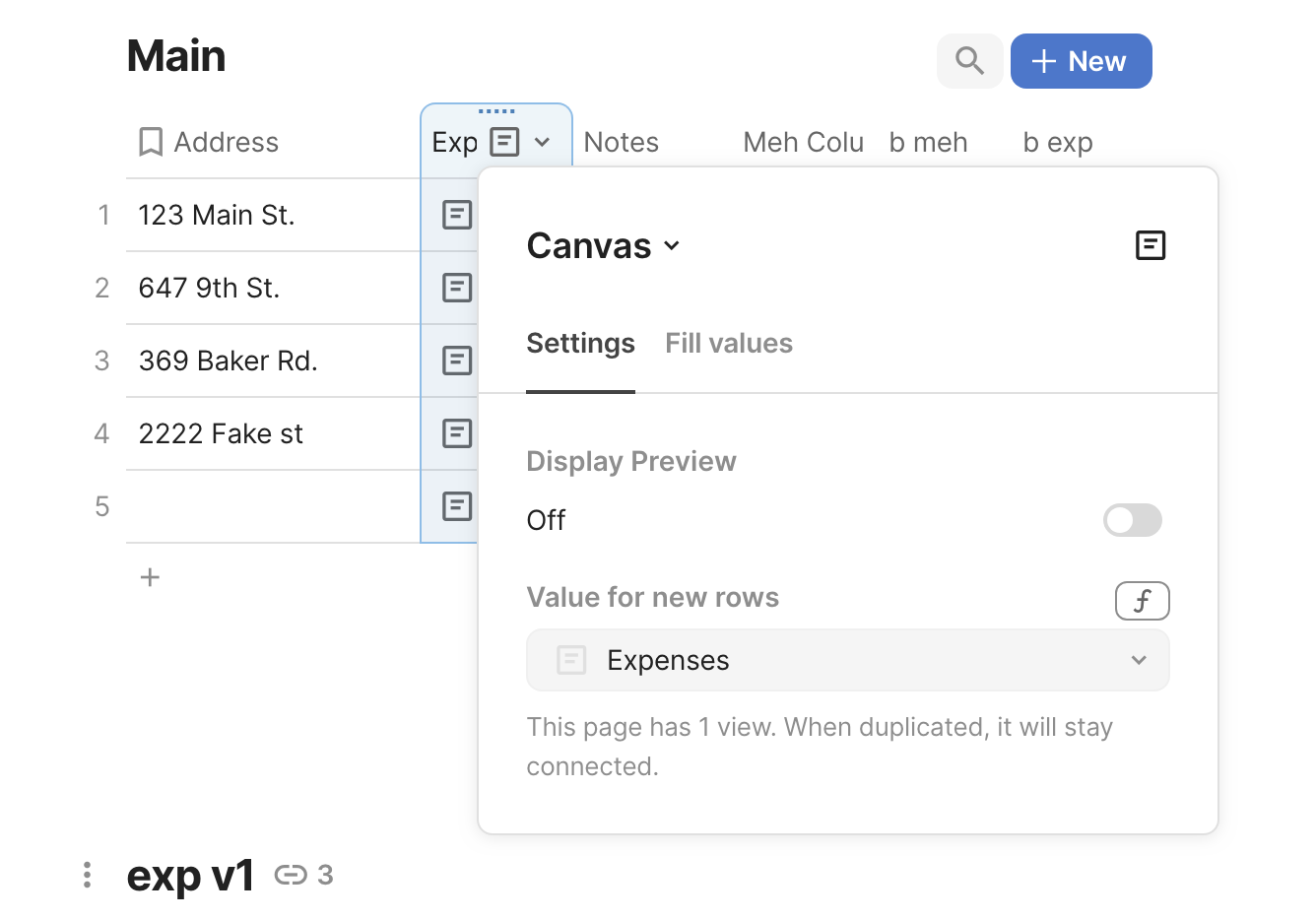

I made 3 canvas templates and used them as values for new rows on my Main table. I’d expect when a new row is created, I get an exact copy of the templates they are being populated by. Instead I just get garbage canvases that don’t look anything like their supposed source.
What’s up? Isn’t this the very use case the “Value for new rows” was created for?
When I click on a Notes column, I’m expect to ONLY see the Notes template, but instead my canvas looks like a mix of all canvas templates.

Nevertheless, this may likely be obvious to most of you, but if someone else runs into this here is how I did it based on how I understood @Jannis’s suggestion:
  1. Set up template canvas, set up new rows to bring in your canvas template
  2. create a detail view of the main table
  3. make a new layout to be used only for this view
  4. choose the canvas column to display (make it viewable)
  5. create a button in the main table with “on click” set to “open row” / “this row”
  6. the important part: Set “View” to the new view from step 2.

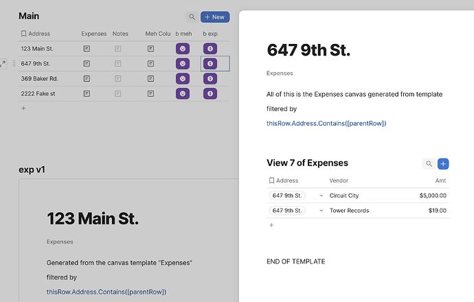

STEP 1
STEPS 5 & 6
RESULTS

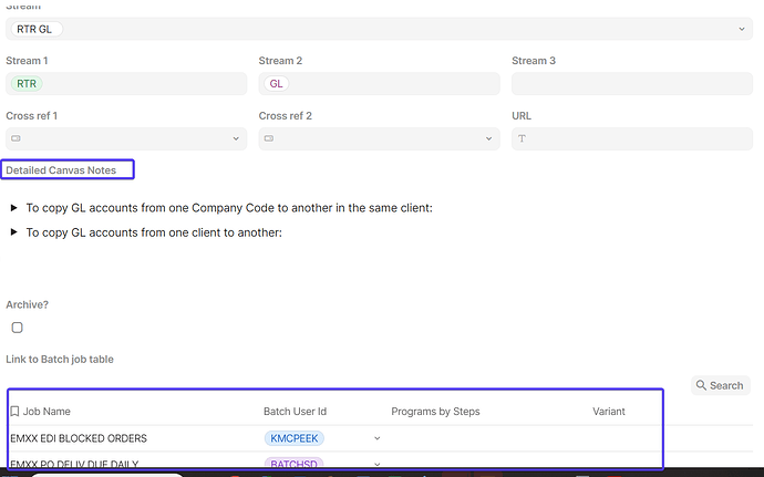

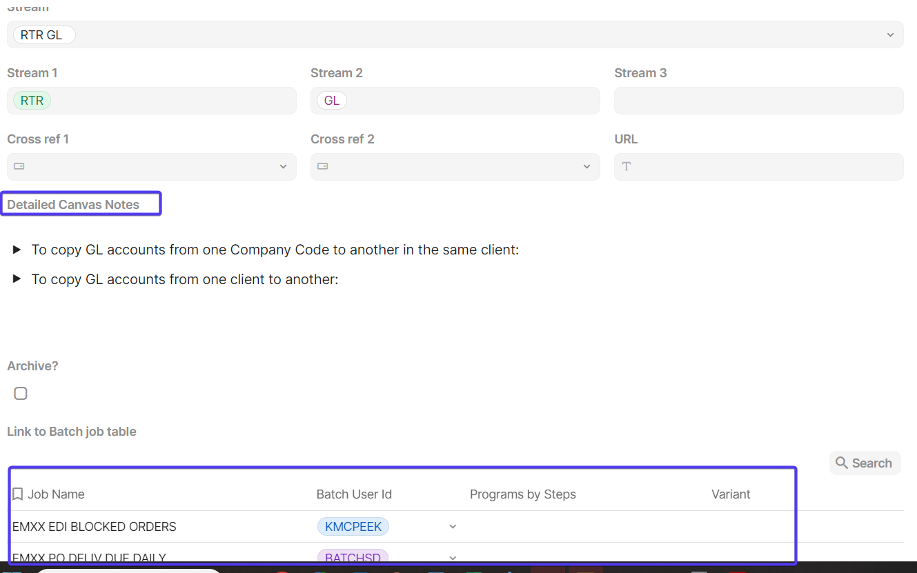

I do not know why you have three different canvas column layouts? An alternative approach for the Expenses canvas would be to use a subtable, or a link to a table. In the example below I have a link from specific business process row in the business process table, to the batch jobs table:
You could also use a sub table with a relevant filter.

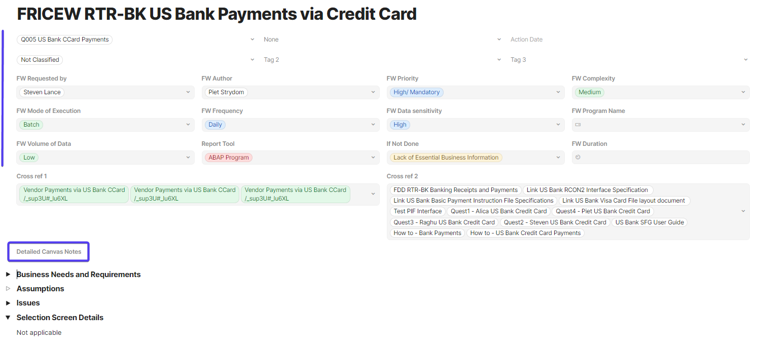

In a document I have, I have one table called thoughts, with each row a specific thought type. Two example thoughts are Functional Design Documents (FDD) and the other is more technical, FRICEW.
In the “Value for new rows”, the following formula selects a boilerplate to pull into the row.:
Below is an example of the FDD Boiler plate that is been pulled into the Profit Centre Accounting design doc, and filled in.
The next is an example of a FRICEW.
The layout in the canvas column is different, but it also has a different detailed view/ modal. - All the fields starting with FW are specific to FRICEW rows, and are not used in other rows/ thought types. In the cross reference columns you can see some examples of other thought types, e.g. Links, Tests, Questions and How-to’s. (Not all have specific boilerplates for the canvas columns, some are just generic blank pages. Some thought types like Links do not make use of the canvas column at all, unless I summarize info from the doc that the link refers to.)
