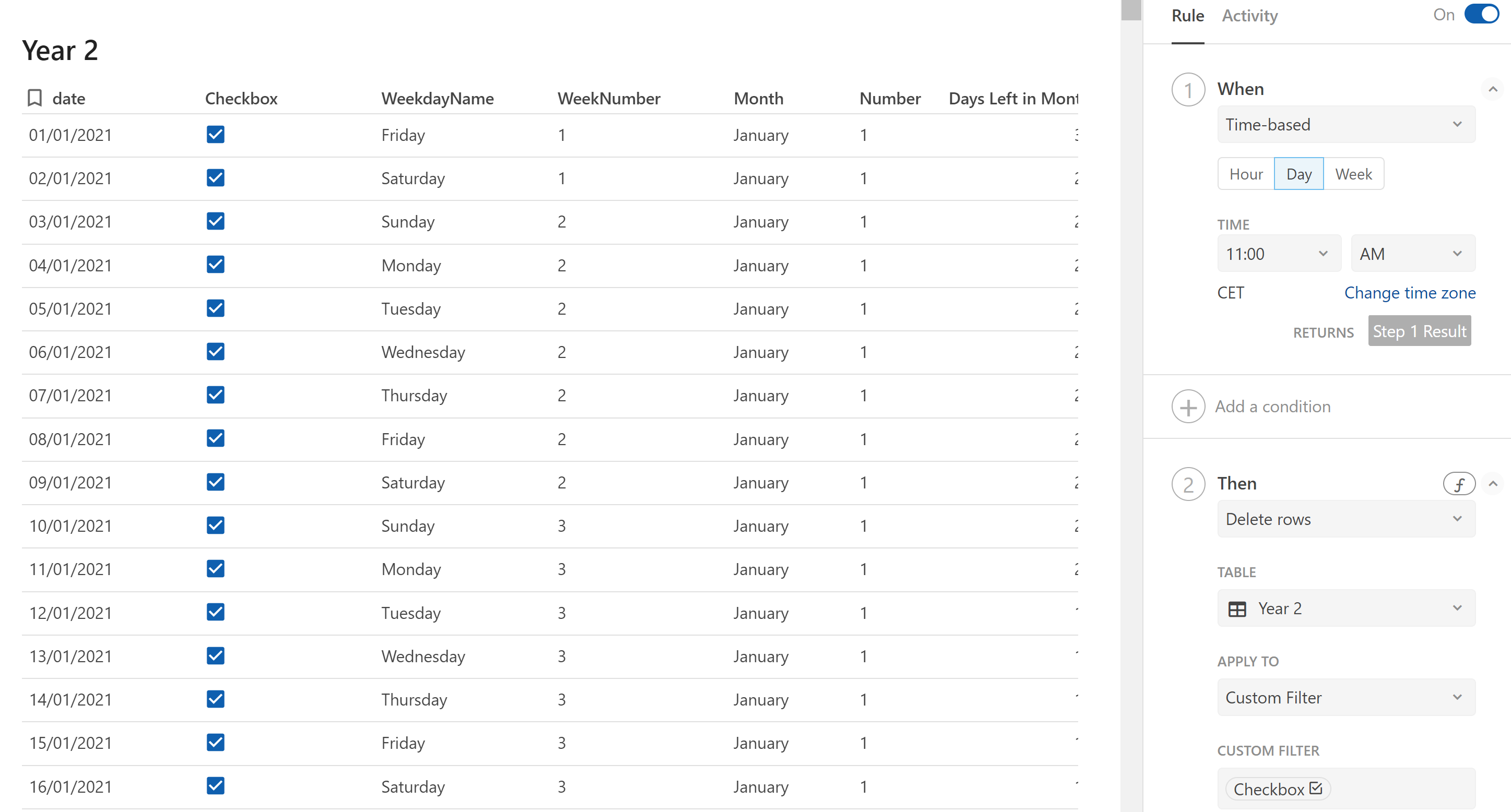

In case you are still looking for / working on solution the one below I tested and works. I created a table name Year. This table has a column with all the dates of the year 2021.
the automation runs every day
in my test case 11h AM
the delete action has a filter, the checked check box., see also this blog
the checkbox contains this function:
thisRow.date < Date(Today().Year(),Today().Month() - 9,Today().Day())
