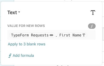

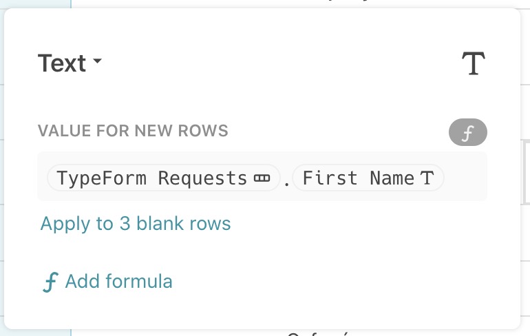

@Christiaan_Huizer In case you’re interested, here’s how I ended up doing it.
I used your FormulaMap to make a new row in table 1 and copy the the ā€œcompany nameā€ to a column that is a lookup of table 2.
Then for each of the columns, I put a formula in the ā€œValue for new rowsā€ that looks up the related value. What this does is enter the info as looked up but pasted text rather than a permanent lookup. This is exactly what I was looking for as I want populate all the fields but allow them to be editable, or have the ability to make a brand new row without any lookup data.
Thanks for your tips on the FormulaMap thing!

@Christiaan_Huizer Here’s a sample of how it works:
wonderful solution @Dominic_Symons1
applying per column the ā€˜new row’ logic instead of the standard lookup via a formula, turns rows into editable fields. If you want to improve your data, this is an elegant way to operate!
