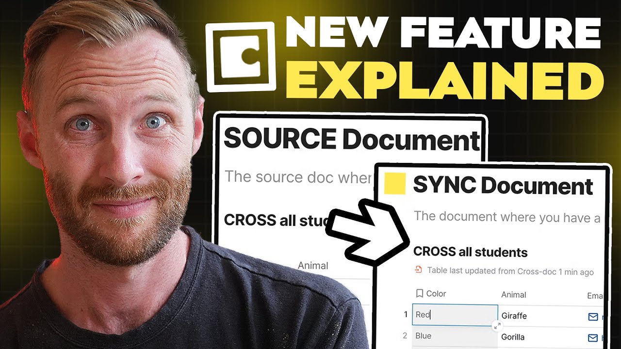

Oh yes! That’s my video - it’s a much more technical and complex way to create two way syncs and not necessary for what you’re trying to do.
For now, your answer is cross doc. Cross doc is a pack (codas word for integrations) that allows you to pull in two way editable databases from one doc into another.
Now, there are some drawbacks to cross doc, but I cover everything cross doc in this video here

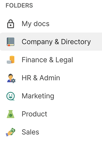

One thing I was trying to accomplish was to have a contact button on each row of a table of SOPs for the lead person of that SOP. (Via WhatsApp or email). And a master team DB with their contact info. Use a relation to pull their WhatsApp number for the button input.
The original database would live in the folder / doc in HR - as that department would be in charge of updating the database.

Hi Anastasia,
Here is a link to the post I talked about above:
It is just an encouragement to experiment with Coda. There are no right or wrong ways to do things, although sometimes some ways may be better. I have one or two very early docs that I look back and chuckle, but what I did worked even If I would build it very differently now.
But that was a very simple doc. My big doc I have re-invented several times over the years. EVERY TIME I have moved more information that used to be in different docs, into the main doc.
As for your specific comments on the People database/table and the contact details. I would try and keep it all in a single table, in a single doc. If there is a need to store confidential information, then add that confidential info in a cross doc.
