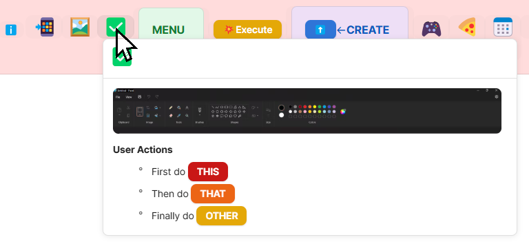

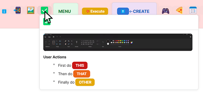

There is a way to control exactly what appears when you hover on an item in Coda.
I have created a pack and template doc for this.
To install the pack and the necessary table/formulas, just create a new page in your doc and type
/Agile Popups
anywhere on the canvas. Then follow the instructions that appear.
You define each popup layout as a row in the Popups table (and give it a NAME).
Then anywhere you have the formula @NAME.PopUp you will see the first item displayed and when the user hovers on that, the popup window you defined will appear.
The template doc has a few examples to show how it works. You should replace them with your own popups. This mechanism can also be used to create drop-down menus as well.
The formula at the heart of this is…
Object(
    ' ',thisRow.Display._merge(),
    '  ',thisRow.Content._merge()
Since the Display and Content columns are canvas-columns, you can create almost any layouts you like for the popups.
I will post a video on this shortly.
