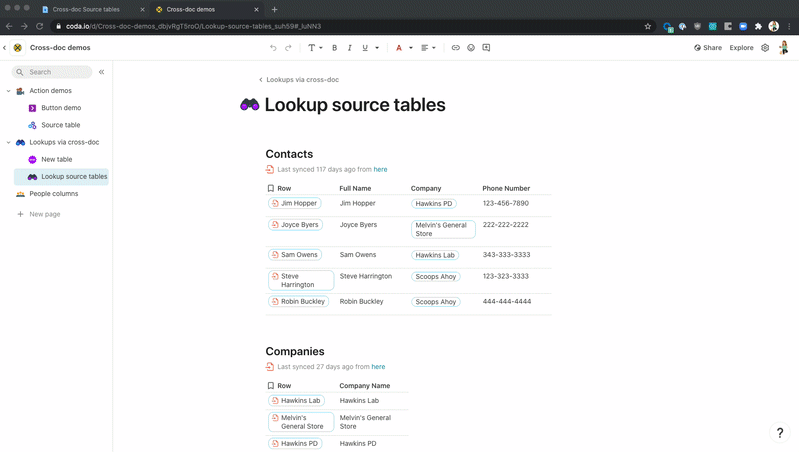

Hey Sonny, sorry to hear about the frustration with cross-doc!
When you add a new column to your source table, it won’t show up by default in your synced table. But you should be able to include the new column once you sync, either from the row column (see gif) or by adding a new column with the formula [Row].[New column name]:
Is that what you’re looking for? Let me know if that’s not quite what you’re after!
Omg Hannah, I feel so stupid right now.
This is indeed what I was looking for and wasting my time on…
Thank you for the swift reply.
