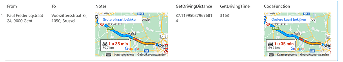

Yup! The distance from the pack is the driving distance (& duration) between two locations - Rather than what was returned from Distance(...) formula.

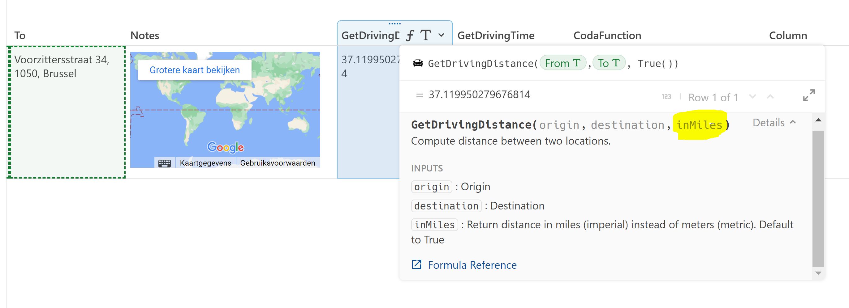

hi @Kenny , thx!
I did not notice that you return the distance in miles, we use the metric logic (Km). Once I know this, we can work around it (but adding the Km option would be wonderful, I did not see how to do it).

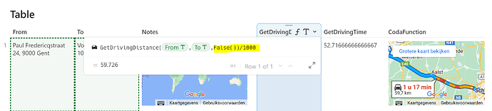

I got it based on your example!
this is super and will work very well in many cases, merc!
RE: Showing metrics (Meters) vs versus miles
  • Looks like you found it!
  • I did notice the inline documentation is unclear - Thanks for letting me know, I’ll update it to make it more clear.
