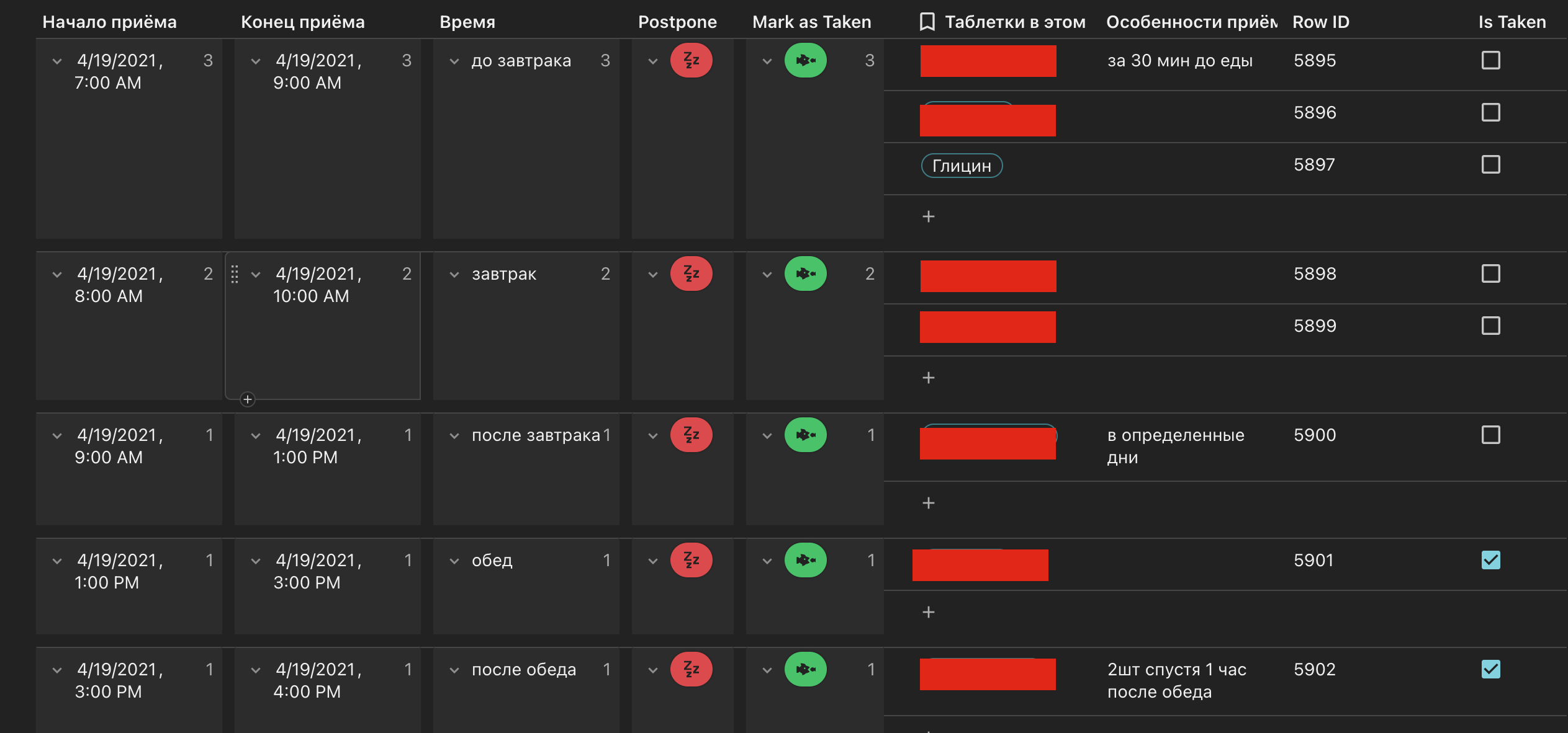

Thanks, @Christiaan_Huizer I’ve filled a bug report on forum and redone my document to be more codaish. Having lists in a cell (several values in one cell) is not optimal unless list entries are very primitive (e.g. referenced tables with just a couple of columns). In my case such approach restricts further manipulations.
So instead of having list of medicine in one column I now generate a row per date, taking time, medicine and then group rows by taking start time. That provides more flexibility and remove glitches with “unknown object”.
