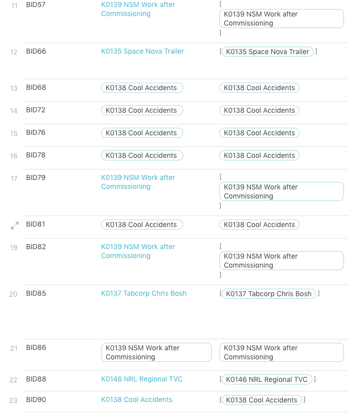

I’ve got a button in a table essentially just adding a new row to another table with small bits of data. And I noticed that in this table, one of the columns had two different types of - er - format (?) for the same data when displaying it, even though in the original table, all the data looks the same.
A picture tells 1000 words.
Here’s the data in the new table put there by the “add row” button action.
In it, columns 1 & 2 are added by the button. Column 3 is just a formula looking up the parent table using the first column ID :slight_smile:
Now - notice the light blue job number/names. And some are even from the same project (so the data is coming from the same master project table at some point!).
I made the third column in the hope of figuring out what was going on - and noticed the square brackets in the data. What does this mean? I’m hoping it might help me track down why theres two different forms for the same data.
I suspect its a case of some data being placed by a button, but also being editable. Or some such thing. Its a fairly complex set of tables (for me at least) and tracing how its happened is tricky. I can’t replicate it with dummy data - or at least, haven’t managed to yet!

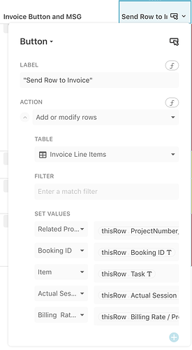

Hi @Brendan_Woithe
Can you add a picture of the table with the button and the button action? It might be helpful for identifying the problem.
Nice idea - but it doesn’t really show much…
I do it this way (rather than related columns in the invoice table) so that one can edit the info (as sometimes small changes are needed in the info before we send the rows from the same project over to XERO to actually make the invoice. (Still working on this implementation, but tests have things working nice and smoothly through zapier)

And here you can see that the job numbers that appear differently in my first screenshot in the first post also are different here. They DON’T have the square brackets.
So my first question - is where do the square brackets come from?
This data is placed into the booking from a button in my project. But I think what happened is someone accidentally deleted a few bits of data and I just put it back in by typing in the project ID (rather than being placed in by an action looking up the data!)

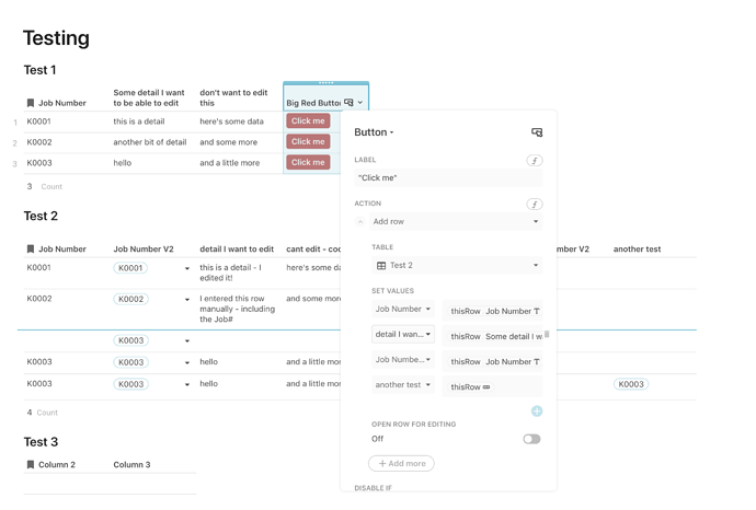

See this test. Two different ways of entering the job number into test 2 table - one just using text and one using lookup (which I love in order to get quick info of the parent table). Both can be entered from the button above or manually.

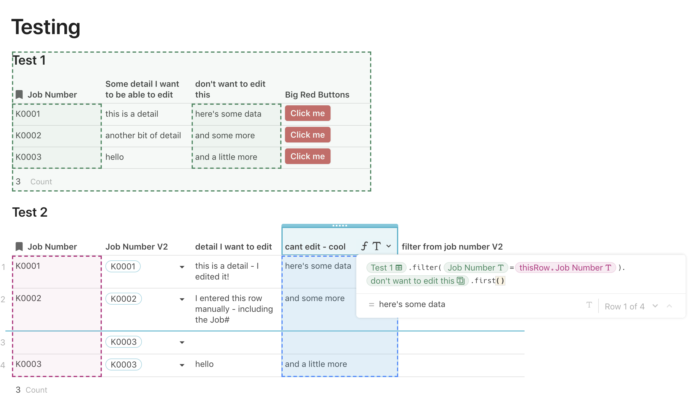

YET - look at the two final columns in test 2. One uses the filter command as I understand it - and it works great. But using it based on the column Job Number V2 (which is a lookup) means it doesn’t work. And while I have managed to get it working elsewhere in my doc, I think its more by brute force/chance rather than understanding what is actually going on.
And I really need to understand it hey - otherwise I waste a lot of time bothering folk here / trying to debug my tables!
So this works:
And this doesn’t:
I’m guessing its because its trying to compare a lookup right (for the filter formula)? So what would the correct method be? Am I on the right track?
Job number v2 is already a row reference so you can replace the filters with just [Job Number V2].[don't want to edit this]

I was looking for a way to insert the ROW into test 2 via the button, and its as simple as just doing =thisrow() in the action.
Then looking closer at what data that actually leaves, it is @K0003 - and the @ of course is VERY important.
