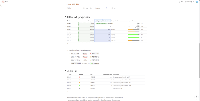

Hello @Valentin_Serry ,
Here is an example of how to set up a progressive bar, but there are many other ways to do it
Sincerely,
Thierry

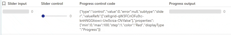

This requires black magic though: you need to take the control object of a Slider and mix in a few properties to turn it into a progress bar.
Here’s the single formula. Don’t forget to set column type to Progress Bar. This is a hacky trick that may break any moment (and can even break your doc) so use at your own risk:

I am particularily impressed because the ‘color:’ property in the ‘properties:’ object of the slider control does NOT appear in the JSON of a regular progress bar (as seen by _Merge()) !!
So you must have experimented to find it (or am I missing something here?)
Anyway, I had to roll up my sleeves and put on my coding hat to figure out what you are doing in the formula you posted. Deep voodoo magic indeed. Well done sir.

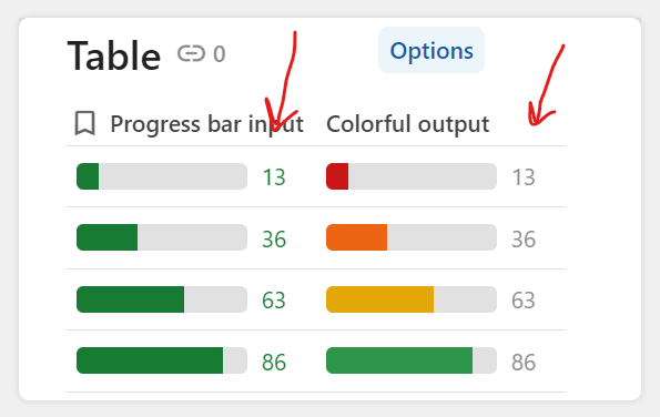

Oh well, my trick is still relevant if you only want to recolor the progress bar but keep the label grey:
(Left: cond fmt. Right: my trick)
