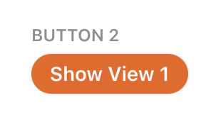

You’d like to click this button in View #2 and switch to View #1:
