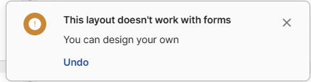

You need to switch the selection to Detail view, apply the quick style, and then switch back to Form view. When you do this, a warning message will appear stating that the current layout is not compatible with forms. However, you can still edit it normally, and I haven’t encountered any issues with this approach.
