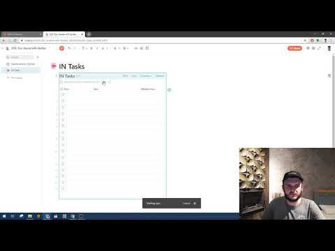

[Video] Swap a cross-doc table in a doc (e.g. duplicate a doc and share with a different client)
Here’s a new spontaneous tutorial that I just recorded :slight_smile:
As a Coda expert for hire, I need to track my work for different clients. Obviously I do it in Coda, and I want to do it in a single doc so that I can see all the summary in one place. Today I was rebuilding it and thought it would be nice to make a template that I could copy and share privately with each of my ongoing clients, populated separately with only the data each of them can see.
Previously I showed how to build this with Zapier. This time I decided to try and build this with Cross-doc. This is tricky because when you want to import a new view and delete an old one (for the previous client), you’ll lose everything you’ve already built on top of that imported table, such as added columns and views. In this tutorial I show how to rebuild the doc so that everything you’ve built is preserved, and you can swap the private pieces of data easily.
Pardon my hard accent and my #coronabeard :slight_smile:
P.S. When copying a doc for another client, first delete that synced private table, then duplicate the doc, then import the new synced private table. This is so that the previous client’s data is not leaked into the doc history.

OK I had to watch this twice! So let me see if I got it IN Tasks is the table you build the doc around (graphs views) and you filter that to only import the row ID so all other data is occulted. Then you still build your client specifc view table in your source doc & import that table in, and then push that data back into the ‘IN Tasks’ table such that it reboots the views and graphs that are already set up? Genius! :brain:
Yes, pretty much it.
The idea in general is this:
  1. You have a front-end table in your doc that you cannot swap. You build everything around that table.
  2. You have a back-end table (a data source) that you use to populate the front-end table. E.g. by linking a row from a back-end table to a row in a front-end table through a lookup, e.g. by ID match or whatever.
Either can be “normal” tables or sync tables, depending on what you want to build. The benefit of having a sync table as a front-end table for a sync back-end table is that you don’t have to bother for adding missing rows yourself (e.g. with an automation) — sync table applies row additions/deletions automatically. There may be a bit of out-of-sync time (e.g. when one table synced already but another still haven’t), but eventually they’ll both be synced.
