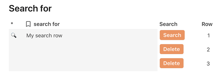

The button option can show “Search” on a button and really just be something to click on when the real action that lets the search happen is just clicking off the cell you’re typing in. But if it row is after the first row, it’ll show “Delete” in the label and delete the row instead. This is a better visual for what they are seeing and might help them easily fix the issue without worrying about it.
Add column called “Row” with the formula
thisTable.Find(thisRow)
Add a button column and for the label formula, use:
If(Row=1,"Search","Delete")
Then for the button action formula, use:
If(
  Row=1,
  _Noop(),
  DeleteRows(thisRow)
There might be other options, but these are the two I could think of.

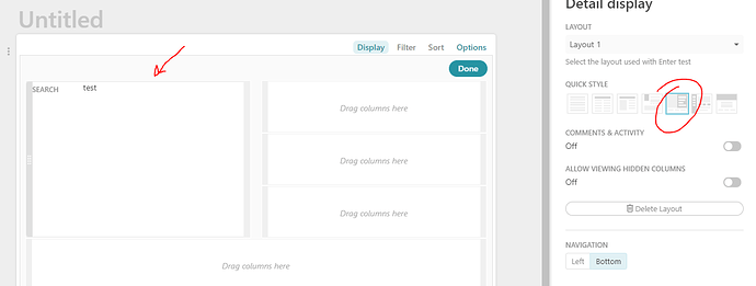

Third option is to use Detail layout and set it up to take as little space as possible:
You’ll have the “1 of 1” paginator in the bottom though. But hitting Enter won’t add new rows, so that’s a plus.
P.S. If you don’t mind a missing underline when the search field is not focused, but are after the smallest view possible, here’s the ultimate option:
It results in this:
A nicer contender:
Results in this:
