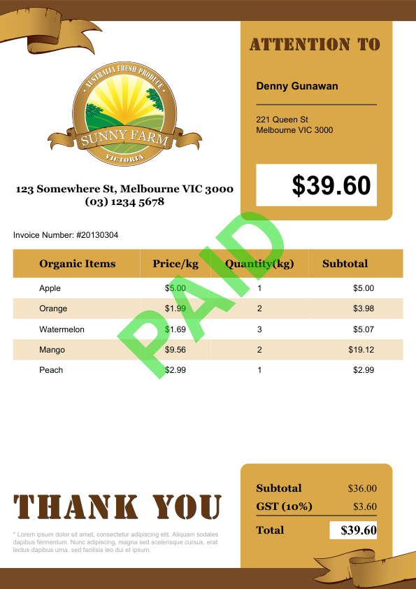

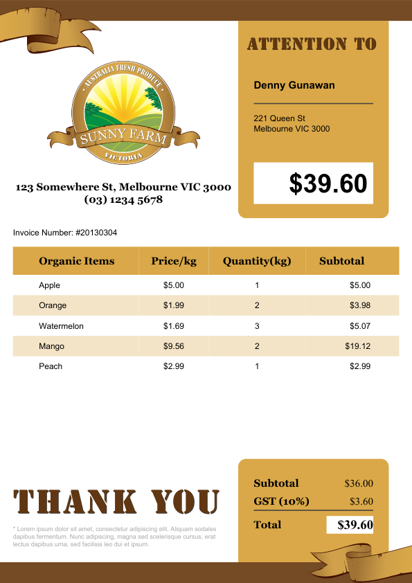

New formulas!
VoidPDFs()
PaidPDFs()
DraftPDFs()
They are all customizable, also, feel free to request more presets!
great: what about ‘example’, ‘confidential’ ?
