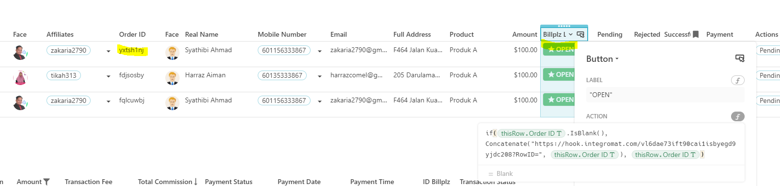

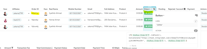

Hi @Tim_Sherman ,
I’m currently building something similar to what you did, but I don’t really understand how you used concatenate to include a payload in the webhook url. If you could describe that process this would be VERY helpful. Thanks a lot,
Jay
Hi Jay
Sure thing. In my example above, I want to be able to create a new “Project” record in Coda, and automatically have Integromat create a OneDrive folder specifically for that Project, with the OneDrive folder URL passed back to Coda so that the project folder can be opened via a button in Coda.
In Coda, I have a table in which each Project is represented by a row. So each Project has a RowID, and other columns such as Project Name, Owner, etc. I also have a button column in the Projects table, with the button action set to “Open hyperlink”. If there isn’t already a OneDrive folder URL recorded in the “Folder URL” column for a Project, I want the button to fire a webhook to Integromat to create a new OneDrive folder. If there is already a OneDrive folder URL for this Project, I want the button to open the folder.
To achieve this dynamic response from the button, I set the button’s link URL to:
if(thisRow.[Folder URL].IsBlank(), Concatenate("https://hook.integromat.com/xxxxxxxxxxxxxxxxxxxx?RowID=", thisRow.[Row ID]), thisRow.[Folder URL])
In my real doc the “xxxxxxxxxxxxxxxxxxxx” is actually the long string that uniquely identifies the Integromat webhook (you can get this from your Integromat webhook module).
Now, getting to your question, the payload here is simply the Coda RowID, which I want to pass to Integromat via the webhook. I use the concatenate
function to generate the webhook URL, which includes the RowID for the relevant Project.
On receiving the RowID via the webhook, Integromat uses it to retrieve the Project Name from Coda, and creates a OneDrive folder named with the RowID and the Project Name, e.g. “1. My First Project”. Integromat then passes the new folder URL back to Coda to populate the “Folder URL” column for the Project, again using the RowID to ensure the URL is logged against the right Project in the Projects table in Coda.
In case you are wondering, I also use an if
statement to label the button in Coda, so that if the “Folder URL” column is blank, the button label is “Create OneDrive Folder”, and if the column is populated, the button label is “Open OneDrive Folder”.
Hope that helps!
