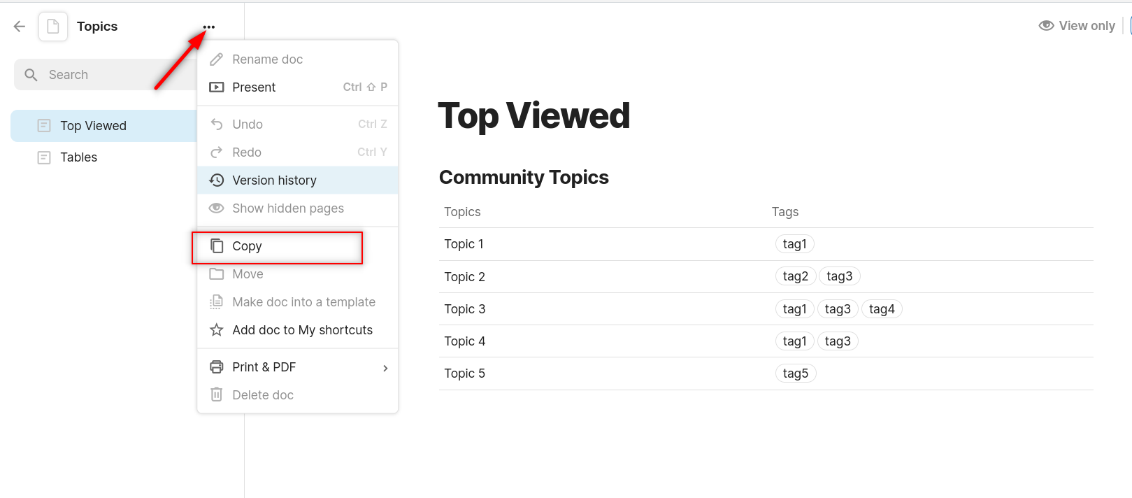

Dear @PolarBear,
Just open the doc in Coda and then you can create a copy of the doc, that you will be able to manipulate the way you like to or to see the formulas used, is that your question?
Thanks. That works for me - forgot I can just copy it.
Also found out that Contains didn’t work - had to use ContainsText instead.
